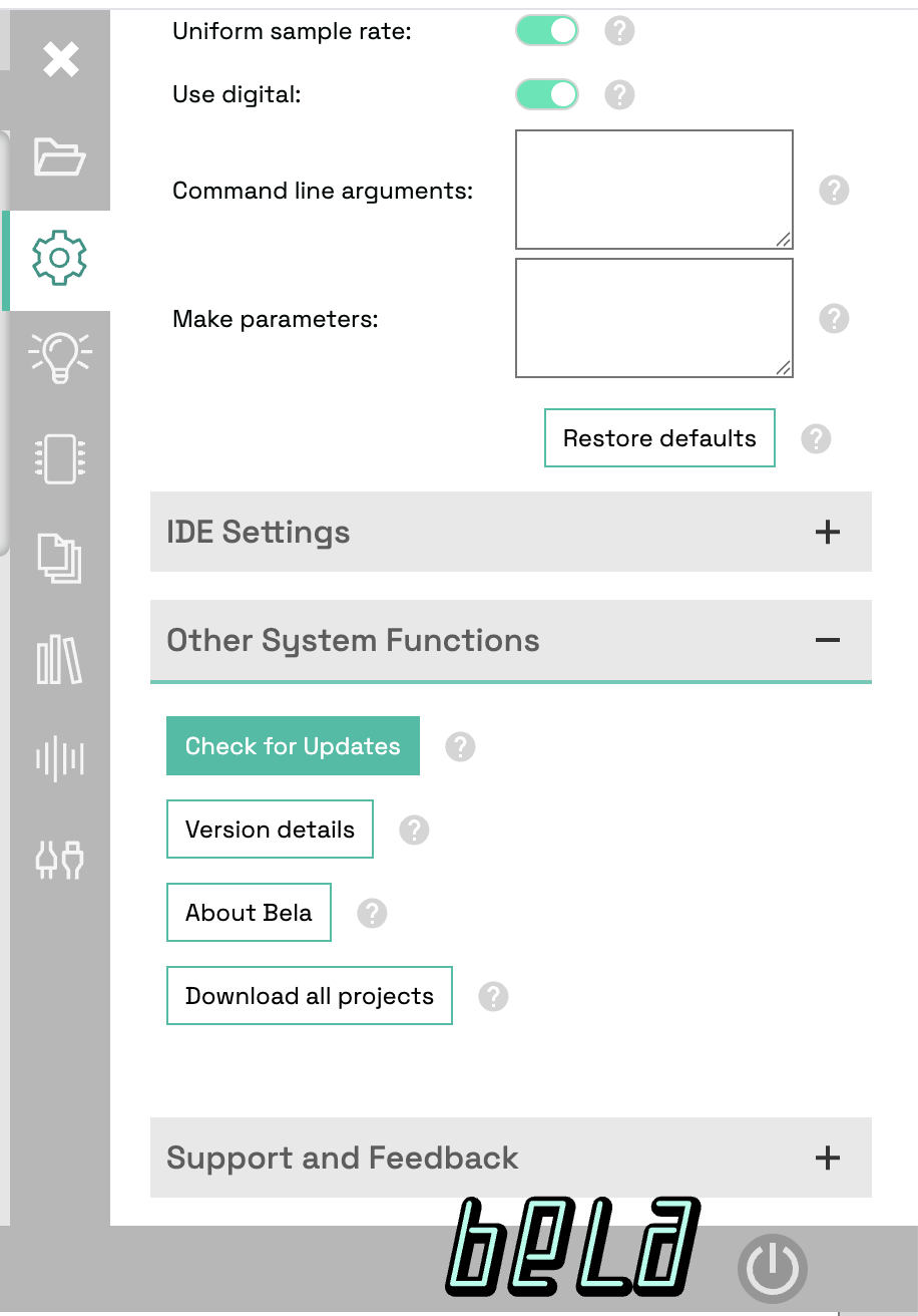

Before you begin any update, download all projects on your board to back them up. Go to the Settings tab, and under Other System Functions, click Download All Projects.

In the Bela IDE, go to the Settings tab. Scroll down to the Other system functions section, and click the Update Bela button:
Then, you’ll see this dialog box:
Click the Choose file button, and select the Bela zip file you downloaded from Github. Click Open. Then, click the Update now button.
Your Bela system will automatically update itself to the version you selected. This process takes about ten seconds.
Warning!
Don't try to use the Bela IDE during the update, unplug your Bela system, or navigate away from the IDE in your browser!
When your update is complete, refresh your browser. Your update is now complete!
